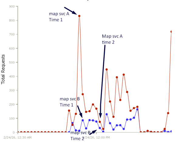

My biggest question is how on earth "Map Svc A"with Total Request of 831 at Time 1 has Average response time of under 1 second whereas "Map Svc B" with Total Request of just 31 has max Response Tme of 221 seconds ? At time 4, all  both Map Services A and B are really slow.
What is going on ? How to read the server stats correctly ?

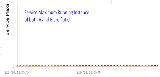

The graphic below shows that Service Maximum Running Instances all 0.
Here is the graphic about Total Request of Map Service A and B at two different times:

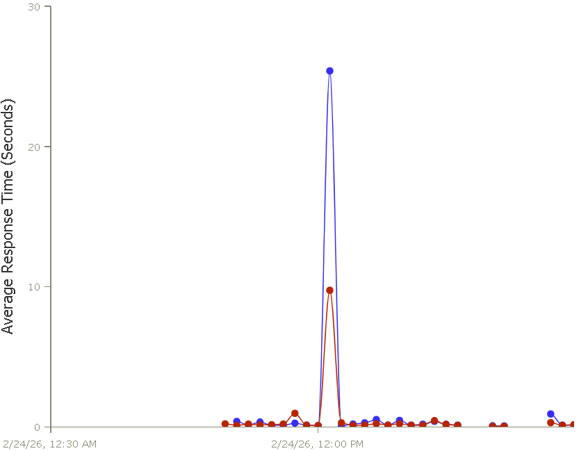

Here is a graphic about Average Response Time:

Total Request: This is the volume of hits you have e.g. how may views of the map service

Average Response Time: this is just the Average response over all the requests
The reason for the big discrepancy in time will be because SVC B is probably a complex service compared to SVC A or SVC A can have a cache, for example a boundary of a state will be less complex than a boundary of a neighborhood what we call a cadaster. or SVC A can be a MAP Service and SVC B can be a feature service which is an editable service and takes a lot more time to draw. Or SVC B's data source can be a database in SQL Server and SVC A might be a file on disk called a File Geodatabase.

Being hit by heavy Total Request, why the Service Maximum Running Instance lie flat 0 for both Map Services A and B ? Shouldn't they be picking up the request ? Or may be there is no available instances to process the request ? I set the instances to a fixed number. For Map Service A : min 2 max  5; Map Service B : min 2 max 4.
By the way, Service Maximum Running Instance is the number of instances that you set to handle the request. Those map service A and B are feature services and being accessed by mobile apps and desktop, possibly concurrently, but not all the time.

I rarely look at the Maximum Running Instance stats.  I have never found it useful and it does not appear to align with the other stats I am seeing.  We use very few feature services - we use map services and image services.  Here are charts of our most popular map service.  This service depicts our tax parcels (~450,000 polygons) and it receives about 270,000 hits per day.  It is configured for min=1 and max=6 instances and it is running on a site with three machines.  So the true min is 3 and the true max is 18.
This was captured at 9 am on a Thursday morning showing the last 24 hours. You can see the running instances drops to 1 during the quietest part of the day and is frequently at 6 during the busiest part of the day.  I don't understand why your Max Running Instances is showing 0 - it should be showing 2 if your feature services are using dedicated instances with min = 2.
