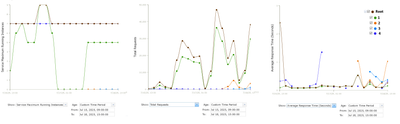

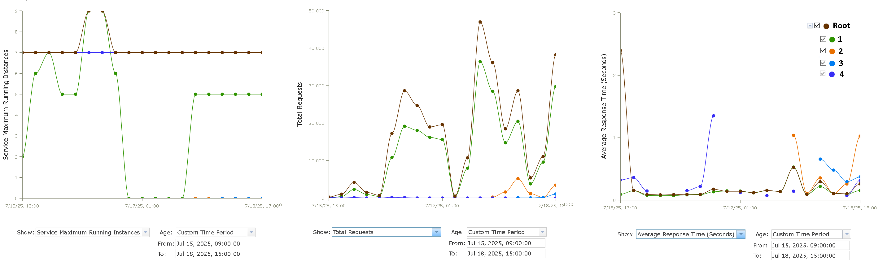

I want to have some clarity about reading the Service Maximum Running Instances in Arcgis Server Statistic. Have 4 services running under Folder 0.
If I add all running instances (1-4) , the sum is not equal to the number of instances in the Root Folder 0.
So, how do I read the graphic correctly and find out the number of total running instances ?
Thank you
4 Replies
JoshuaBixby
MVP Esteemed Contributor
The maximum running instances setting is per machine/node of an ArcGIS Server site.  If you have a site with 2 machines and a max of 4, then it is possible to have up to 8 running across the site. Are you running a multi-machine site?
yockee
I am running a single site machine. That statistics come from a single machine.
FYI, in this machine I have :
- 2 services running dedicated instances, with maximum of 4 and 3 instances.
- 5 services running shared instances
How do I read the graph correctly ?
yockee
does anyone have idea ? I am still waiting with high hope. Lol
ModyBuchbinder
Is it possible that you have some services in other directory?
The total is for all services without the system/utilities and the shared instance
