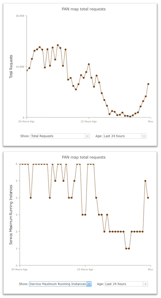

I rarely look at the Maximum Running Instance stats.  I have never found it useful and it does not appear to align with the other stats I am seeing.  We use very few feature services - we use map services and image services.  Here are charts of our most popular map service.  This service depicts our tax parcels (~450,000 polygons) and it receives about 270,000 hits per day.  It is configured for min=1 and max=6 instances and it is running on a site with three machines.  So the true min is 3 and the true max is 18.
This was captured at 9 am on a Thursday morning showing the last 24 hours. You can see the running instances drops to 1 during the quietest part of the day and is frequently at 6 during the busiest part of the day.  I don't understand why your Max Running Instances is showing 0 - it should be showing 2 if your feature services are using dedicated instances with min = 2.

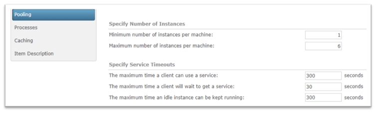

And don't forget the number of running instances are tied to several timeout settings.  Once an instance is activated it will hang around in an idle state until the timeout value expires:
