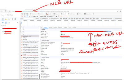

Please excuse if my explanation is not accurate, but there is no error.
In the below screenshot we can see that I can access portal web maps and services using the NLB URL. But, the backend request to server is not through the NLB configured on server web adaptor. Its the root domain server URL which end users does not having access to making it un-useful. The users must access the server services using NLB configured URL for ArcGIS Server.

An ArcGIS enterprise (portal and federated servers) can not be referenced by one alias.  Internal and external users must all use a single subdomain like.
https://gis.domain.com/portal/home
typically we design for external usage and use split DNS to creates internal and external aliases.  It is impossible to have different names, so if you have existing content on an internal alias you either need to start again or use the internal name on the web (probably not a good idea).  Esri professional services have a way of changing existing content to use a single new alias, but otherwise it’s unsupported.
ultimatelu it all comes down to not being able to have a single webcontexturl in the portaladmin properties.
