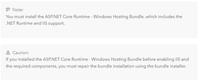

The only thing I can think of is this warning of having things installed in the right order from Esri:
https://enterprise.arcgis.com/en/system-requirements/latest/windows/arcgis-web-adaptor-system-requir...
