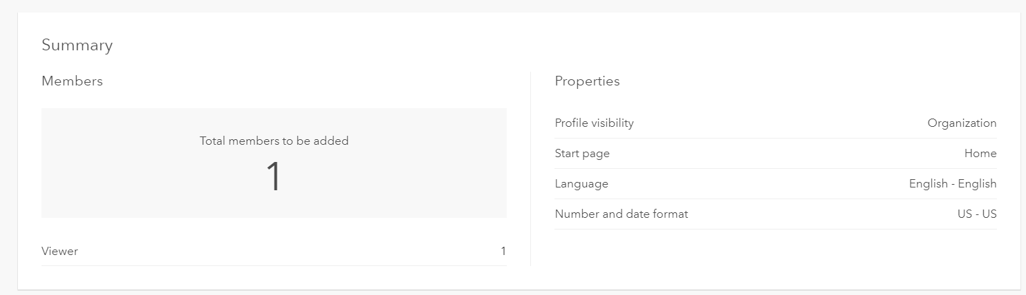

Hi there,
When a new user is created there is no way to set the number/date format. it is always US-US!!  >:(
I do not want this for my users as we do not live in the US.
Is there a way using the python API to bulk update this value for all the users in my org? Should it not be a setting in the organisation that is applied to all new users by default?
I understand people can do it in their profile, but I do not want to have to ask all the members to do this.
Regards,
Marc

Hi Mark, you can set this when creating your new users. When you reach the 'set member properties' screen, select the settings tab and each of these settings are configurable:
The settings apply to dates across your portal website.
