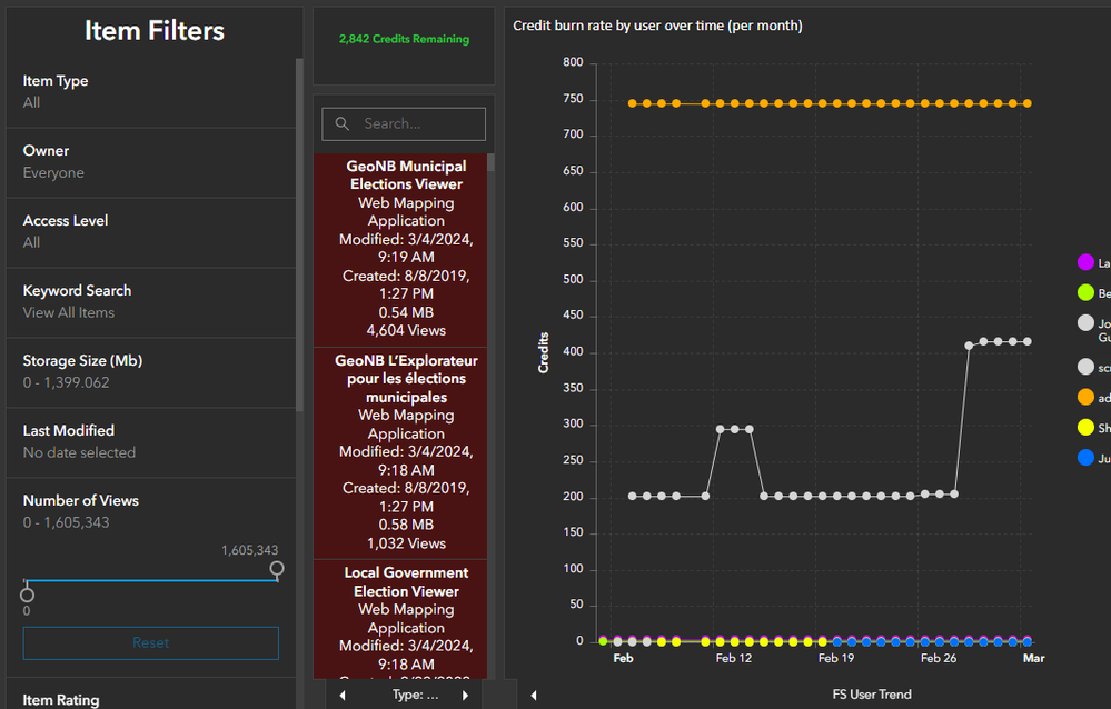

Since you are only concerned with the items that are consuming credits you can use an ArcGIS Notebook to get a list of all the items in your organization.  This sample Notebook should get you started.  Remember it is the database storage that is the most expensive so look for large Feature layers or Feature services hosted in AGOL.
Building this dashboard will help you monitor for new items added to your AGOL organization.  I used this blog to replicate the dashboard for my AGOL organization.  Here is a sample image from our dashboard showing recent increases in feature service storage:
Good luck,

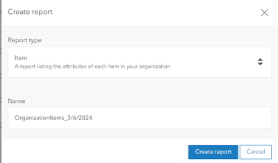

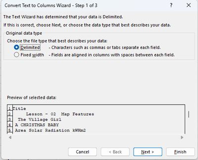

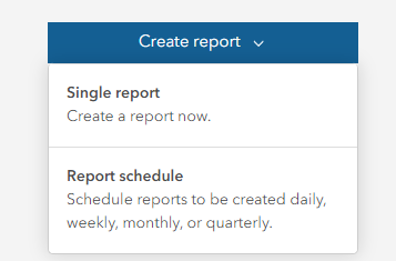

HenryLindemann
Hi @JR_CHN, if the service type is a Hosted Feature in AGOL, it's is hosted online, if it does not have the hosted tag it is referenced and either coming out of a 3rd party system or your Enterprise.
Then you need to go to Organization -> Status -> Reports -> Create report -> Single report
select Item
create and download the report.
you open the csv in excel then select column A go to Data Tab.
Select Text to Column
Delimitated then comma.
The Columns you are interested in is K Feature Storage and P is hosted.
Feature Storage is the expensive storage whereas File storage is very cheap.
If is Hosted is true you are being billed for the service.
