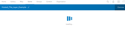

AndresEcheverri
After upgrading to 11.2 we notice some Tile Layers (Hosted) item detail pages do not load in Portal.
In the Content tab you can still select the layer and from there share it with a group, and within a Map bring the layer in (search for the layer in Portal and bring it in) and then display it in the web-map. But trying to check the summary, description, credits is not possible as the page does not load. This does not happen with all hosted Tile Layers only with a few of them (there is not consistency with the behaviour, some are shared with group, some are not).
AndresEcheverri
After weeks of engagement with Esri support, the answer is that the issue started in version 11.1. Status of the bug is "In Review", and while "in review" it might affec newer versions, like 11.2
BUG-000163200 - Hosted Tile Layers overview page in portal at 11.1 hanging after in place upgrade.
