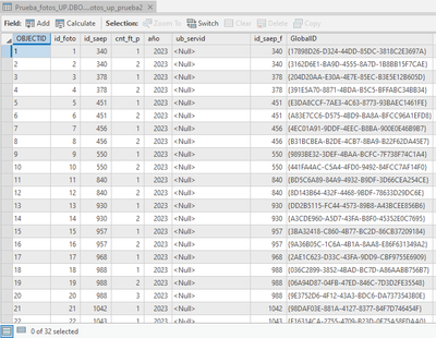

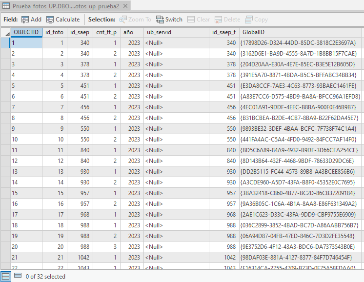

3. I have a table of photos tha I created, where each row represents a photo, this table has id_saep, so it is possible to relate it with my feature class (bridges).
(example of the actual table)
4. Each bridge can have at least three photos.
5. I use the table of photos, and attach the photos using the tool "Enable Attachments", and load the photos.

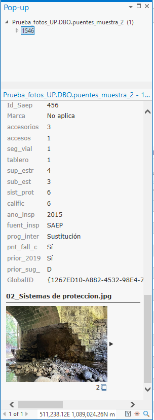

6. I Created a relationship between my feature class and my table of photos. In ArcGis Pro you can see that it displays the photos just as I want.
Yo can click in the small black arrow to switch from photos.

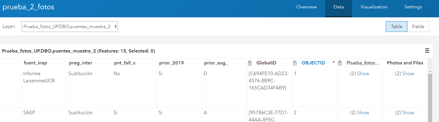

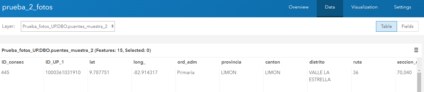

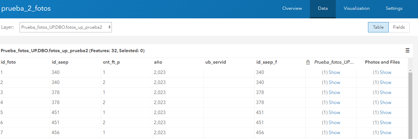

7. I published the web layer with the table all together so I got this:
(example of some colums from the feature class).
(example of some colums from the table of photos, yo can see the attachments.

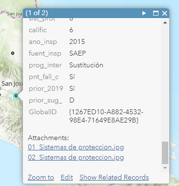

8. This is the result in the pop up with out doing anything:
9. for some reason the table from the feature class shows that it has attachments:
But this attachments are from the table of photos.
What can I do to get this done correctly?
