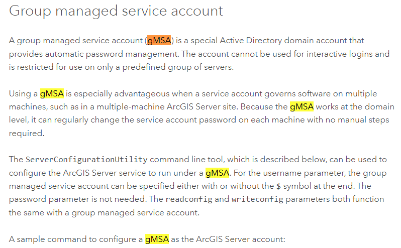

I'm configuring arcgis server to run on a group managed serviced account. I used the ServerConfigurationUtility command line tool according to this documentation https://enterprise.arcgis.com/en/server/latest/administer/windows/the-arcgis-server-account.htm and it says a password is not needed. However, I got an error 'Invalid password specified for (the group managed service account)'. Our IT told me the group managed service account doesn't have a password. They have also granted the account 'log on as a service' permission. I also tried to change the 'Log On as' for the arcgis server service to this account but the service would not start. How can I configure arcgis server to use a group managed service account? Thank you!

If the server (host machine) is registered by your SAs in the gMSA then it will just work.  There is no configuration on the ArcGIS Server side.  It's simply just a case of entering the gMSA account details as stated.  All the configuration is completed by your sys admins.
If the command line is not working for you then try the GUI approach described here:  https://enterprise.arcgis.com/en/server/latest/get-started/windows/what-s-included-with-arcgis-serve...

ServerConfigurationUtility.exe /username mydomain\enterprise-gmsa$ /writeconfig c:\temp\domainaccountconfig.xml
