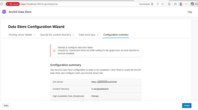

1- Error No.1: Attempt to configure data store failed.
Caused by: Connection timed out while waiting for the graph store on local machine to become available.

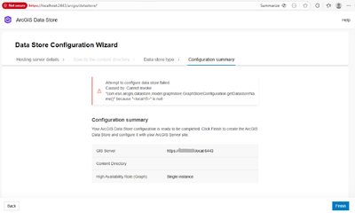

2- Error No.2: Attempt to configure data store failed.
Caused by: Cannot invoke "com.esri.arcgis.datastore.model.graphstore.GraphStoreConfiguration.getDatastoreName()"because"<local15" is null
Error No.1
Error No.2
So far, I encountered two different errors during the configuration between ArcGIS Server and ArcGIS Data Store, and both errors are related specifically to the Graph Data Store.
