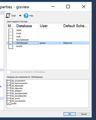

If you want to be sure the user will have read access to all data on the Dataowner schema, you could try the following:
On the SQL instance, go to Security > Logins. Select the OS user and view properties.
Go to the User mapping tab. Change the default schema and select the db_datareader role:
This should give select permission on everything within that schema and should be viewable through ArcMap.

Is that Security > logins in SQL studio?
