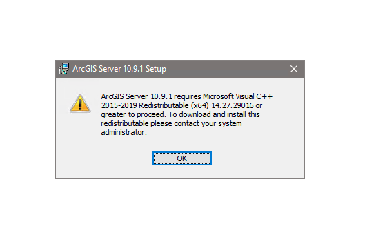

I'm attempt to upgrade my ArcGIS Enterprise 10.8.1 Deployment to 10.9.1 version, but when I execute setup.exe application is returning error: ArcGIS Server 10.9.1 requires Microsoft Visual C++ 2015-2019 Redistributed (x64) 14.27.29016 or greater to proceed.
Alright, My windows server 2016, is updated with last version of Microsoft Visual C++, and I uninstall and install again couple times, and nothing, same error again and again, Portal and DataStore same.
I'd like some help, I've have search since last week about this error.
ArcGIS application seems to cannot detect Microsoft Visual C++ installation or something like that

Accessing installation log, there is an error:
" [ERROR] Microsoft Visual C++ Redistributable (x64) detected to have multiple instances installed on the system "
