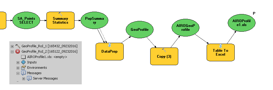

I have a GeoProcessing tool that develops a Census profile based on a user defined study area - the final output using Table to Excel.
The model operates perfectly in ArcGIS and produces the output that i require. It also publishes to Server without any errors or warnings. However, when I run the tool on ArcGIS Server I get an error saying that the .xls is <empty>.
Any ideas what could be happening here?
Image below of model and then error when I run the model
Thanks
Justin

I have had a look at the logs on Server Manager and it seems that the problem may be with the parameter that I am taking from the DataPrep python script tool. The final table that I need to link to Table to Excel (essentially GeoProfile, the output parameter from the DataPrep script) seems to be inaccessible when I run on Server.
This is the error log that I get on Server Manager:
Error executing tool. Model2 Job ID: j91533738840043b48bf730482226e32e : ERROR 000732: Input Table: Dataset c:\arcgisserver\directories\arcgisjobs\geoprocessing_dev\airogeoprofile_roi_gpserver\j91533738840043b48bf730482226e32e\scratch\scratch.gdb\GeoProfile does not exist or is not supported Failed to execute (Table To Excel). Failed to execute (Model2). Failed to execute (GeoProfile_RoI_2).

GeoProfile is the final table that I want to export to an Excel file. GeoProfile is set as an output parameter in the script and I then connect GeoProfile to the Table to Excel tool in the main model. It seems that when operating on Server the Table to Excel tool is not finding 'GeoProfile' and then can't export the final Excel file.

I've traced this down and it seems that the file that I require (GeoProfile) to be linked to the Table to Excel is not appearing the the Jobs Scratch directory at all when run on server. In fact, it seems that my python script tool is not actually editing and making permanent changes when it runs on server at all however it does this perfectly when run on my local machine.
