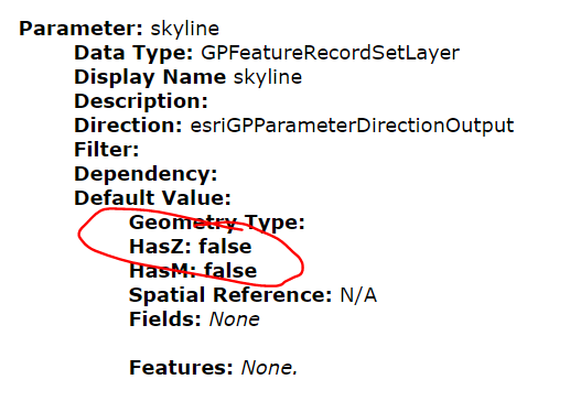

However, when we run the GP service on REST endpoint (or by JS API) using the same input, the output feature layer does NOT have Z. The REST page of the GPservice also shows that output parameter hasZ=False.
We tried to explicitly set arcpy.env.outputZFlag = 'enabled' in the script, and setting the output parameter environment setting in the toolbox, but none of them worked. The output parameter is still not Z-aware.

Updates: We've solved the parameter hasZ=false problem - by changing the parameter type in the toolbox from a Feature Set to a Feature Layer and republish the tool.
Problem is, even with parameter hasZ=true and returnZ set to true when submitting a job, the result returned from REST endpoint still shows no Z value.
