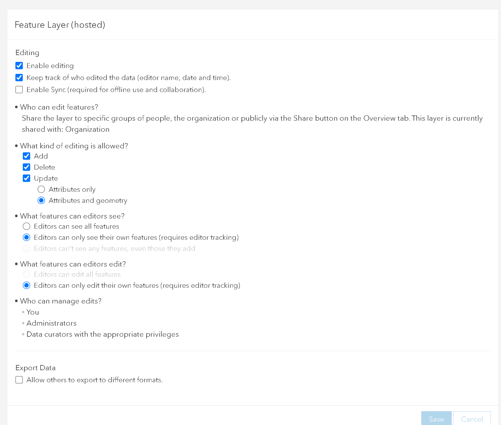

I am trying to create a feature service webhook and I use ArcGIS Enterprise 11.0. I have read that webhooks are in beta version at 11.0, but still, I want to make sure that I am doing everything OK.
When creating the webhook I get the following error: "Error: Feature Service must have Editing and Change Tracking enabled without Sync".
However, checking the feature service properties in the Portal, it looks to me that my setting are OK. I attach screenshot of my settings.
Anybody could advise on this?

I don't know the requirements that Survey 123 puts on the feature service. I do know there was an issue with getting change tracking enabled on a feature service from the item page inside the Home App. That was fixed in 11.2 I believe. The accepted solution on this thread, to use updateDefinition and ensure the correct capabilities is set might be your way to "fix" that. Unless Survey 123 has put sync on the feature service, then correct: you cannot enable the feature service webhooks.
