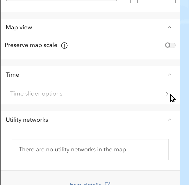

I have a large number of rasters I'd like to publish to ArcGIS Enterprise and visualize using a time slider app.    All of the rasters are time enabled locally but when I publish to Enterprise the time slider option is grayed out in the map.     I've tried uploading .tiffs and File Geodatabase Rasters, individually and grouped.  I don't have an image server,  so I've tried uploading as Map Image Layer or tiled with no luck.

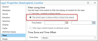

I assume you have used this option to make your raster layers time aware.
If that is the case, then the support should be coming in for 11.3 release if everything does as planned.

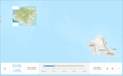

Here is an early preview to hype it up 😄

The reason the time slider does not work in Map Viewer for your case is that the map service doesn't report the necessary time related properties in its REST resources.
If everything goes as planned starting 11.3, map service will honor that 'the entire layer is shown within a fixed time extent' option for a layer; it will report that info in its REST resources and when a web client such as Map Viewer passes in a time-extent in an export operation, map service will honor that and return correct results showing only raster layers that are within the current time extent. As you see in my animated gif above.

yes, that is correct. In the animated gif above, I used 3 different raster layers. They are not inside a mosaic dataset. And it is a map service not an image service.

In you case, once 11.3 is available, all you need to do is add your raster layers in a map in Pro, make them time aware, and then share that out as a map service.
