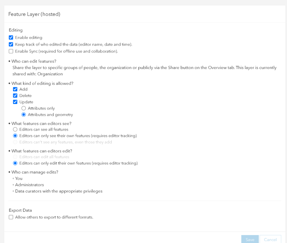

I am trying to create a feature service webhook and I use ArcGIS Enterprise 11.0. I have read that webhooks are in beta version at 11.0, but still, I want to make sure that I am doing everything OK.
When creating the webhook I get the following error: "Error: Feature Service must have Editing and Change Tracking enabled without Sync".
However, checking the feature service properties in the Portal, it looks to me that my setting are OK. I attach screenshot of my settings.
Anybody could advise on this?
KevinHibma
Unfortunately in ArcGIS Enterprise 11.0 when you check the "Keep track of who edited the data" option there, it does not actually update the FeatureService with the required setting. You'll need to manually go into the Rest Admin for the service and update the capabilities to include ChangeTracking using the UpdateDefinition endpoint.

bogdanpalade2
Hi Kevin!
Thank you for your reply! However, when I try to access the "update definition", I get the following error:
"Could not find ressource or operation 'updateDefinition' on the system". I attach a screenshot of the error.
KevinHibma
Hi @bogdanpalade2 - You're attempting to get to updateDefinition from the Server Admin - updateDefinition is in the REST Services Admin, its a very subtle difference.
Your URL will look something like
SERVER.COM/server/rest/admin/services/Hosted/MyFeatureServiceName/FeatureServer/updateDefinition
bogdanpalade2
Thank you very much Kevin! This was the solution!
