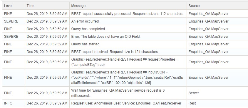

So, I checked the log file in ArcGIS Server Manager and saw this "Error: The table does not have an OID Field".
Log file

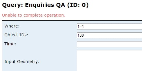

When I try to query at the REST endpoint using the Object ID, or return ID only or return count only, I get a "Unable to complete operation" error. The same "Error: The table does not have an OID Field" error appeared in the log file.
Query objectid

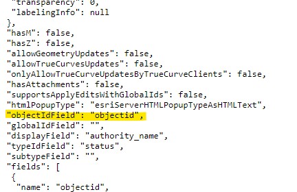

I have confirmed the feature layer has an ObjectID.
ObjectID
