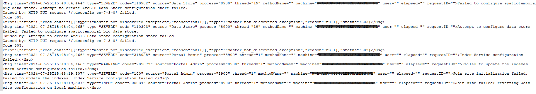

However, after the install and join site, I am getting an Index Service error; this won't start and therefor the whole join site session is cancelled. I have read the logs and just before the index service error occurs, the machine want to configure a spatiotemporal big datastore (on the portal side) but gets a 503 error:
Here is a snippet of the log files. I have seen in the configuration that the spatiotemporal big datastore is a thing on portal, but there is not a STBDS on the Data Store. I have no idea *why* it cannot do anything, but a 503 means Forbidden.
