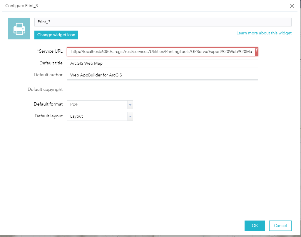

one other thing: did the out of the box printing service (i.e. http://localhost:6080/arcgis/rest/services/Utilities/PrintingTools/GPServer ) work for you?
QiranLiang
Sorry for the late reply, could you give me more info on how to apply this service?
TanuHoque
just copy of the url of the service and paste that as the url while configuring your web app builder print widget
QiranLiang
it said it's not a print service.
TanuHoque
QiranLiang
it said the url is not available
TanuHoque

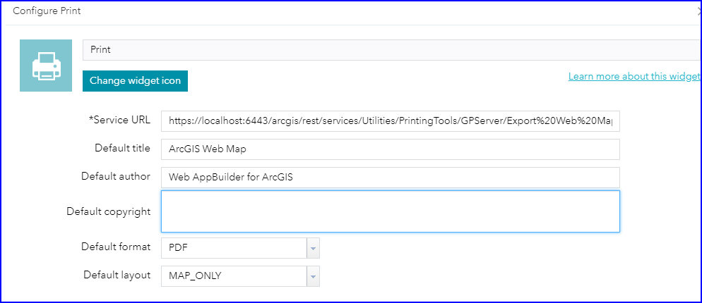

you might need to replace 'localhost' with machine name that is hosting arcgis server.
localhost refers to your machine that you are working on and it seems like the printing service may not be hosted on your machine...
can you try with 'https://gis.engeo.com/arcgis/..... (as per the screenshot you posted earlier)
if that does not work, I will highly recommend you to check back with Esri Support.
