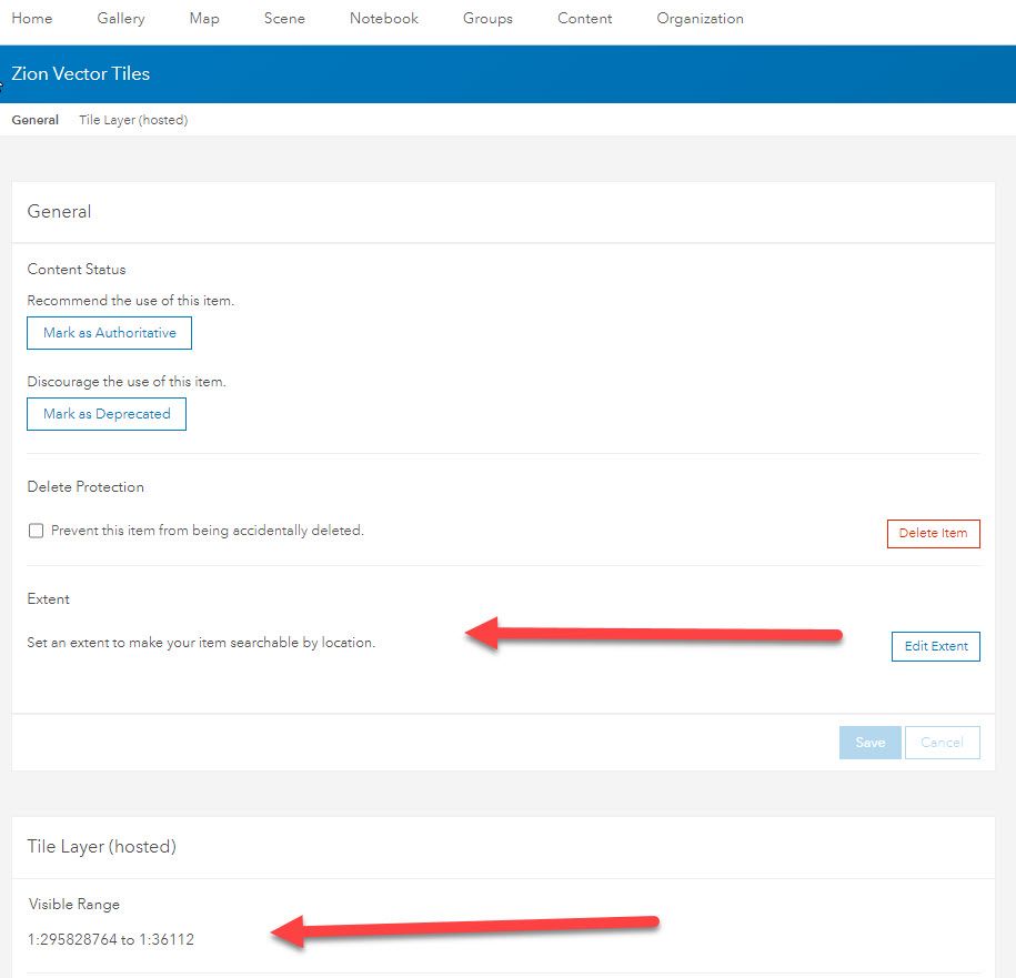

Dear all
I created vector tile package and published to portal. I want to set the extent that when user add tile layer to portal he should not zoom out from certain scale. Please help me out and that how I can limit user that he cannot extend after fixed scale

Hey there,
   You should be able to set the extent of the vector tile layer via the layer settings in ArcGIS Portal. This should allow you to limit visible extent and default extent. Please let me know if this helps! Example.jpgExample.jpg
