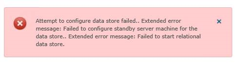

I have a 10.6.1 datastore that has almost 7000 hosted FC in the store this is +- 30GB but I am getting a problem when I try to add a failover.
Problem:
After adding the failover the wizard copies over the datastore and unpacks it. It then fires up one thread to read through the content now because of the volume and a slow server it fails to read through all the content and start up the datastore before the timeout it then fails.
Workaround
I had to copy out most of the data to get the failover to configure but this is a very time-intensive script.
Question
Is there a setting to extend the timeout of the wizard when adding the datastore?
