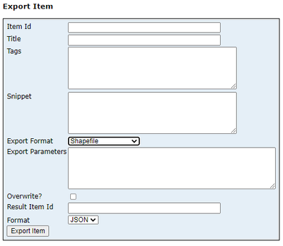

Even further, if you browse to a user's REST endpoint: https://server/portal/sharing/rest/content/users/user@domain/export
You get the following options:
If you enter the item ID of the feature layer, the export proceeds with no error and a ZIP file is generated for download. However, when you download the ZIP it's only 1KB and it's empty. So it looks like it silently fails.
