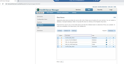

go to ArcGIS Manager Sites Datastore
click on the x icon to remove any ArcGIS_Data_Store Only
open your link again and re-register the datastores with the correct url
https://GEO-PROD-SERV-DATASTORE.GEOCEN.LOCAL:2443/arcgis/datastore

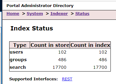

But my services can't open. I wonder if I have to Reindex in PortalAdmin, even the status looks fine?

Can you open the services under the rest e.g. https://dns:6443/arcgis/rest/Hosting and query them if yes then the problem is on portal yes.
