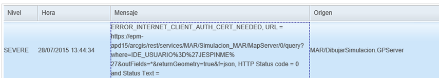

If I consult the logs of ArcGIS for Server (10.1 SP1 QIP), I notice the following error: ERROR_INTERNET_CLIENT_AUTH_CERT_NEEDED
