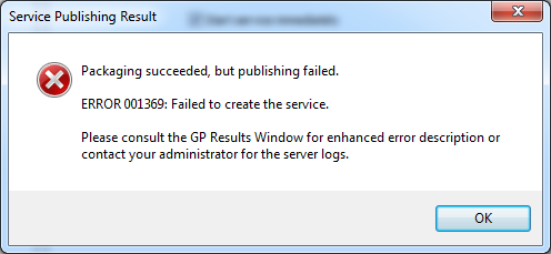

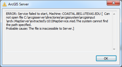

I have a server running ArcGIS Server 10.2.2 that has been running reliably for a couple of years.  I had not created or altered any services for a while, but when I did it last, maybe in April or May, it worked smoothly. This week, I went to alter one of the services running on it, as I needed to change the symbology of one of the layers slightly.  I made my changes to the .mxd, and went through the file->share->share as service dialog as I always do, but when I clicked on the publish button, I got a dialog that says this:
After some troubleshooting involving deleting the service and recreating it, I get this when attempting to publish the service:
The service is actually created, however, but just refuses to start.  Attempting to start it manually, either via the context menu in the catalog or the Manager UI, results in that same error message as seen in the first dialog.
I've tried the following to fix this issue, and nothing seems to make any difference at all:
  • Checked permissions for the .msd file it talks about.  The ArcGIS user owns the entire c:\arcgisserver tree and has "full control" access to it, but the .msd file in question doesn't actually exist.  Notably, for other services on the server, a .msd file does exist.

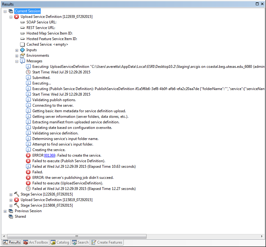

  • Checked the geoprocessing results window in Arcmap for the results.  This is what I get:
