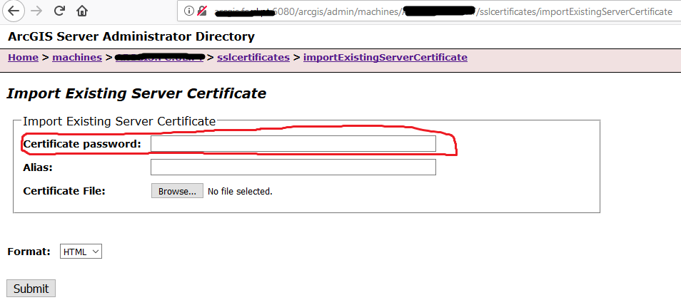

Now I have problems with the Step 8 of  "Request a CA to sign your certificate"
The Certificates were provided by CA. On step 8 say "Click importSignedCertificate, and browse to the location where you saved the signed certificate received from the CA."
The screen ask for Certificate Password.
What password I have to use? If is blank I got fail, if I use the admin password is failing too.
My server nerver asked me to create password for the new Certificate.

Hi Luiz,
Are you currently using a web adaptor for ArcGIS Server?  If so, this step won't be required unless you access services through port 6443.
When importing an existing server certificate, this will typically be a PFX file that contains a password.  If your certificate is a .cer file, you may be able to export this to a PFX in the MMC console:
How to Import & Export SSL Certificates in IIS 7 | DigiCert
