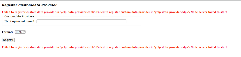

I am following the "Create a Yelp Custom Data Feed" documentations (https://developers.arcgis.com/enterprise-sdk/guide/custom-data-feeds/create-a-yelp-custom-data-feed/) to make sure everything is working properly. However, I've run into the following error when I try to register the Custom Data Feed "
Failed to register custom data provider in 'yelp-data-provider.cdpk'. Failed to register custom data provider in 'yelp-data-provider.cdpk'. Node server failed to start

I was able to figure out the issue. The issue was that I had installed 'npm install yelp-fusion' at the app level and not at the data provider directory. Tip, make sure you install 'npm install yelp-fusion' at the data provider directory level. Thank you!
