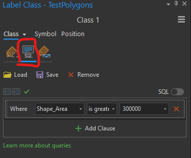

There are 2 ways to do this.
You can have the condition in the Arcade expression:
if($feature.Shape_Area > 300000) {
    return $feature.OBJECTID
// if $feature.Shape_Area doesn't work, you can also try Area($feature)
Or you can have the condition as SQL statement, making the expression very simple:
Have a great day!
