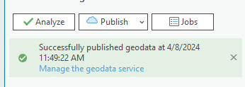

Hello,
I have been doing several test trying to publish an enterprise geodatabase service from 2 different ArcGIS Enterprise 11.1 and 10.9.1 and 4 different geodatabase (SQL Server Geodatabases). Every time i publish a geodata service, it published  with no error

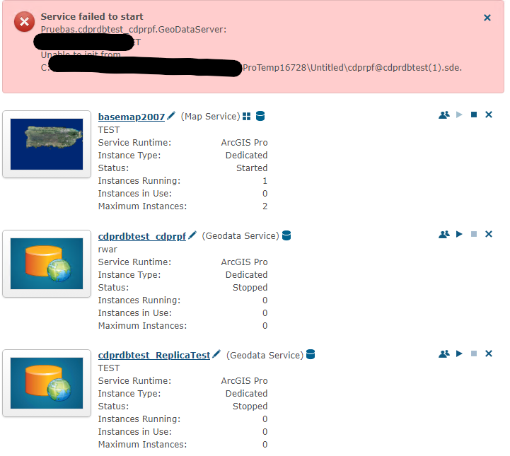

But when I go to server/manager the service is stopped and when i try to run it, it gave me an error that i have not found any solution
The errors are:
- Failed to construct instance of service 'Pruebas/cdprdbtest_cdprpf.GeoDataServer'. Unable to init from C:\Users\a...
- Failed to initialize server object 'Pruebas/cdprdbtest_cdprpf': 0x80070057: Unable to init from C:\Users\a...

Having the same issue here. Publishing succeeds with no errors, geodata service is stopped, in ArcGIS server manager when I try to start the service I get the following error message:
Service failed to start
xyzxy.Replica_A.GeoDataServer:
DC-GISWEB
Unable to init from \\NNN.NN.NNN.130\shared\abcxxx.sde.
ArcGIS Enterprise 11.1.0, Linux
