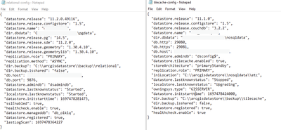

I looked into our Datastore config, and found this:
Last known status upgrading, which took place December 1st.
Any ideas why this could happen? I assume this is the reason for most of our Workflow issues, as it was working, previous to the December 1st upgrade.

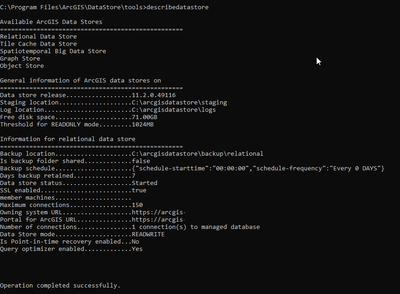

Thank you for the reply! When I use describedatastore I get this here:
(I intentionally hid a few pieces of information)
The Tile Cache as far as I'm aware is not working, it's not validating either.

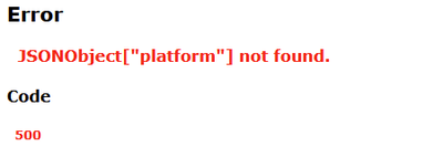

Thank you for the suggestions! I attempted to unregister the Tile Cache and it ended up giving me this error here:
I have an open ticket with support, and I'm hoping they'll be able to check it out with me, but I will be giving the scene things a shot here shortly!

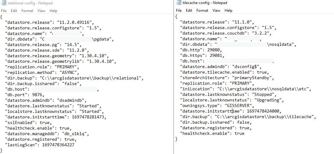

Thank you for the reply! I attempted to validate from the server manager, and it states that the Tile Cache does not validate. When I went through admin path, the Tile Cache presented this here:
Here is a picture of the current and history file for comparison:
Along with that, I have no hosted scene layers that I could experiment with, I looked online as well and I could not find any at this point, if I'm missing them just let me know and I'll give it a shot!

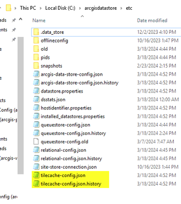

Hey all, just an update, I found what had occurred.
Looks like not deleting these files here could cause a "null" message to occur, but once deleted, I was able to re-register the tile cache easily.
Hope that helps someone in the future!
