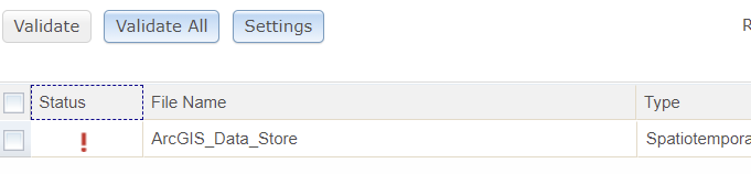

From scratch installations of Server, Portal, and DataStore, I can not get DataStore to authenticate… I get the mean ugly bang with:
"Failed to validate the data store machine 'DATASTORE.VTUSDA.LAN'. 'Could not connect to the ArcGIS component at URL 'https://DATASTORE.VTUSDA.LAN:2443/arcgis/datastoreadmin/machines/DATASTORE.VTUSDA.LAN/validate'. The ArcGIS component on that machine may not be running or the machine may not be reachable at this time.Error: DATASTORE.VTUSDA.LAN: Name or service not known'" in the server log.
