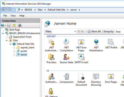

Hi @JoelKyereNNimarko, in IIS your IWA Integrated windows authentication is turned on on the arcgis webadaptor  this should just be turned on for portal webadpator if you just have the one you should install another one as this is best practice currently.
go to the webadpator in iis click on authentication and turn on anonymous authentication and turn off windows authentication
Hope it helps
