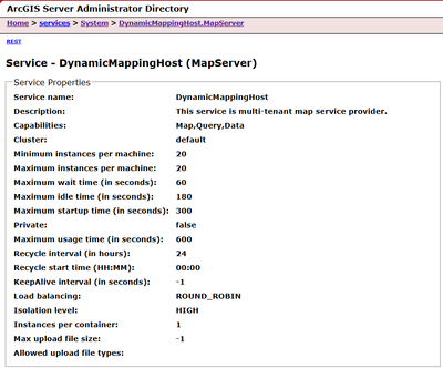

bernhard
Hi,
We have the same error message appearing in our logs.
We have Enterprise 11.4 (Windows Server 2019) with the ArcGIS Server Security 2025 Update 2 Patch installed that fixes BUG-000173043.
I also tried to reboot the DynamicMappingHost service but the messages appear again after a while.
I have also checked the requestids. Those vary and all appear to only occur twice in the server logs. One time with mentioned error message and the second time with a "Error exporting map Error handling service request :java.util.concurrent.TimeoutException" message.
There more then enough free shared instances available and both hosted server (load balanced) run around 60% of RAM. So I don't see any specific services or a ressource shortage as an issue.
Service time settings:
Any ideas what else could generate this error message?
