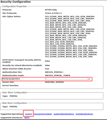

My action logic was to manually perform the Hostname in my Single-machine deployment.
Followed step by step:
1. Go to https://machine.domainlocal.net:6443/admin/security/config
Locate the "Portal properties" field and Bavkup the content. After Backup, I changed any "HOST.DOCKER.INTERNAL" references to my server's Hostname and saved the new configuration.
2. Access the https://machine.domainlocal.net:6443/admin/data/items/enterpriseDatabases/AGSDataStore_ID_Your_ArcGI...
Under Supported Operation, select "edit"
In the Item editor, I also changed any reference "HOST.DOCKER.INTERNAL" to my server's Hostname and saved the new configuration.
After that, I restarted my ArcGIS Enterprise and the system was back up and running with the correct hostname.
