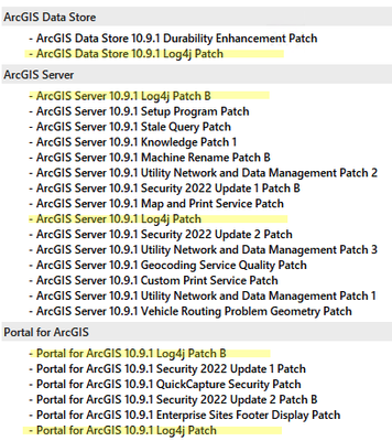

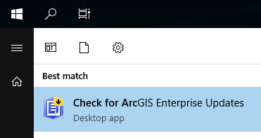

They released patches for this a while back. Run your Portal's Update Utility and you will see the log4j patches there.
Update Utility:
Log4j patches:
Edit: forgot to highlight a couple.
