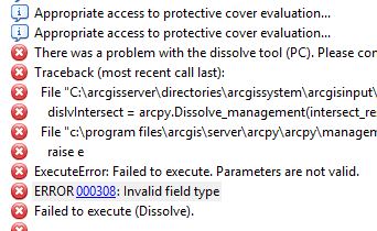

This part of the python script is recursive, in that it will do this process many times on different selected features. I noticed from the error messages it went through it one full time, and then errored out on the second pass (see the first two messages in the picture, that message prints every time it starts a new pass). Does it have to do with overwriting issues maybe? I have arcpy.env.overwriteOutput = True set, but I don't know how that effects in_memory datasets.

The answer was that the GUID data type was causing an issue. I still needed to use this in my dissolve, so what I did was copy the GUID field to a new field of data type string, went through with the dissolve, and then copied the string field back to a GUID field.

I ran into the same issue when generating Thiessen (Voronoi) polygons ... commenting here in case anyone is Googling a similar error message. Looks the gp creates geometry and then joins the full attributes back to the geometry as the final step. Doubtless other tools are adversely affected by the presence of a Global ID.
