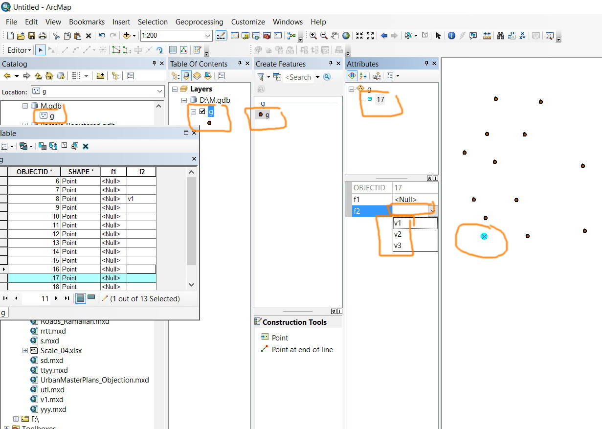

For example, in the screenshot below, as a feature is digitized, its value in the “f2” field gets empty. What I wanted here is to avoid having an empty value and thus once a new feature is digitized, then the ArcMap shall ask for an entry for that feature for the “f2” field. I’m aware of that the “default value” could be a solution, however, I need the data entry to be forcibly required to choose a value from the list to avoid the empty value.

If you don't want to use default value. so I prefer to active  Display the attributes dialog before storing new features. This in Editing toolbar menu > options... > Attributes Tab ( look to below picture)

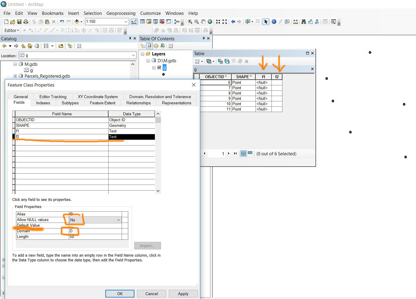

Neither domain nor subtype can resolve the issue due to the fact that ArcMap accepts “empty” value even in case you have domain or subtype.

Greetings@JayantaPoddar - we are also using Collector and JS API web apps and I want to force end users to pick and choose from some values in a domain list. It should not allow them to submit and click OK on Collector unless they choose the value in these fields. I am aware of the Disallow Nulls and how it just makes it a "" or a 0.  That is basically the same thing, in reality. (I know what a true DBNULL is; but a "" is the same thing conceptually in this regard)   It seems this concept of Esri geodatabase design needs engineering, so it can prevent empty user entries. It should make users choose from the domain values.
Anyhow, do you know of any other way or workaround with the Esri platform to make users choose a value from a list of domain values? Or enter text to a string field? For Collector, mostly; but also for apps on JSAPI. This is an essential part of most field GIS to ensure users are doing everything that needs to be done for inspections. Thank you all for any advice.
