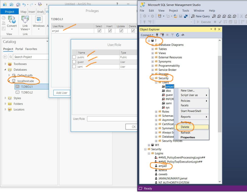

JamalNUMAN
Legendary Contributor
Not sure if the Pro has a tool to delete the database user or the only way to do it is from SQL server
