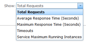

> I envision having a dashboard that I could use to monitor the real-time performance of my Esri Server and the requests that are being made to the server throughout the day. ... would love to be able to see the real-time info of how many requests are being made, what service is getting requested the most, avg response time, etc
FYI in ArcGIS Server Manager, under the Logs section > Statistics - you can see (and create) visual charts of various performance metrics of your web services. While not a "dashboard" per se, they do show performance metrics for the services.
About server statistics—ArcGIS Server Administration (Windows) | ArcGIS Enterprise
