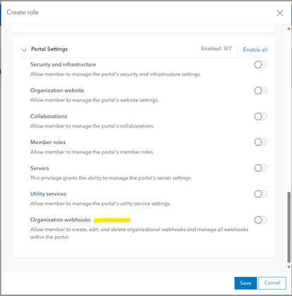

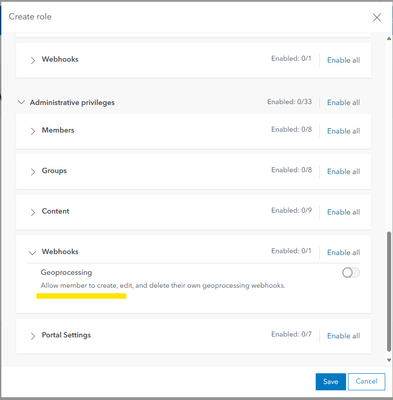

  • For Geoprocessing service webhooks: assign the following privileges to the custom role.
  • For Organization webhooks: assign the following privileges to the custom role.
