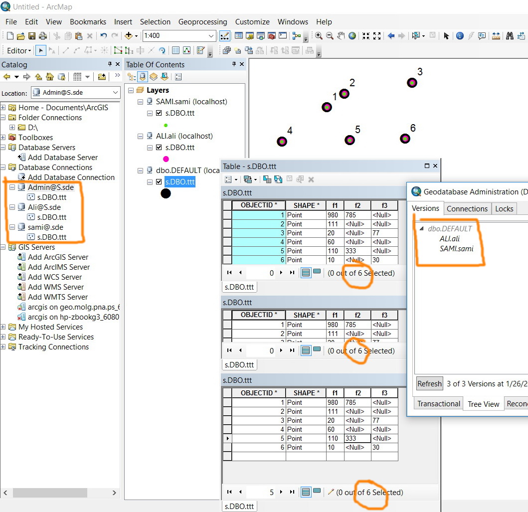

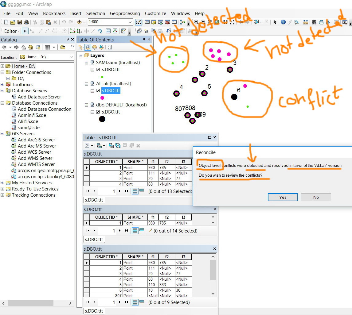

Currently, the ArcGIS shows only where there is a conflict between child version and its parent. What I wanted to know here if there is a way to show all the changes that has occurred regardless if it caused conflict or not so that the data verifier can accept\reject the change. On other words, I don’t need to restrict “resolving” the update just in case of conflict but I need also to have a look on all other changes even in case where there is no conflict and then to decide either to accept or reject.

Hi Jamal - use caution when trying to mass reconcile and post. The behind the scenes action is comparing one version to another....I'm not aware of any way to compare multiple child versions to a single parent, although I think that could be a useful tool. In your later post, you were using the batch reconcile tool. Using that with the abort if conflicts are found would be the fastest way to identify conflicts between children of a single parent.
