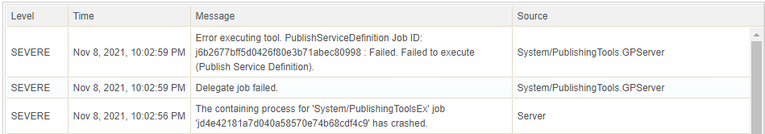

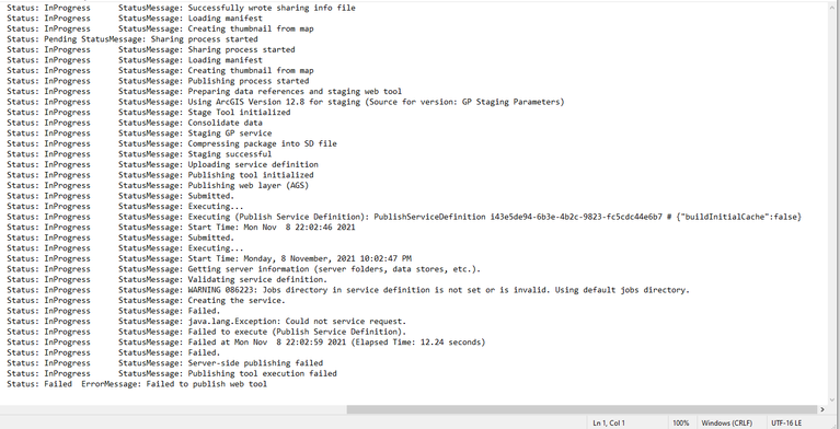

I try publish buffer tools through ArcGIS Pro but got error . see  Error 1
I got log error The containing process for 'System/PublishingToolsEx' job 'jd4e42181a7d040a58570e74b68cdf4c9' has crashed.  see Error 2

Error 1Error 1Error 2Error 2
