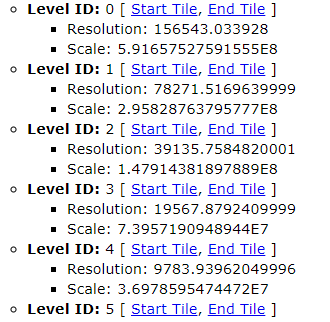

I have tried saving the service definition and uploading it and it works successfully with no error messages, but the map service publishes empty (the thumbnail in server manager shows the map I want though) and no tiles are created in the arcgiscache > service name > map name > _alllayers folder. When I go to my rest/services page, I see the map service there and I see a list of tiles at each scale I want, but if I click "start tile" on any of them, I get a 404, not found error:

I hope someone has some insight because I'm stuck. If the solution is publishing a tile cache to the server before trying to publish the service, what tool would get me started?
