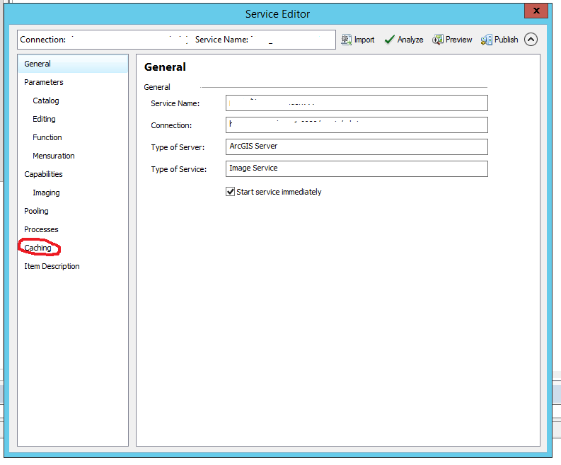

2·         I opened Service Properties

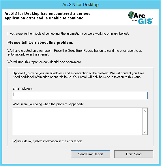

3·         I pressed Caching---Advanced Settings - crashed
Currently (after 1,2,3), I cannot publish a new image service
4          I try to publish a mosaic dataset as Image Service (different name from service1)
5·         I have Service Properties opened
6·         I press Caching – crashed (the same error window)

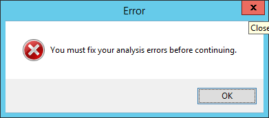

Press on Publish gets
How we do a reboot of ArcGIS Server?

I try to analyze my mosaic database before I created my Image service.... Data Management Tools->Raster->Mosaic Dataset->Analyze Mosaic Dataset.   I used the defaults, but you can have it check other things.  Also, never hurts to update the boundary and make sure you have overviews.
