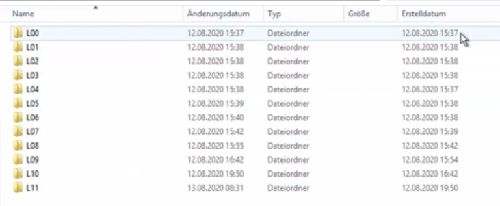

Here is the order of folder creation (right column: creation time):

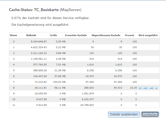

some insight into cache creation:

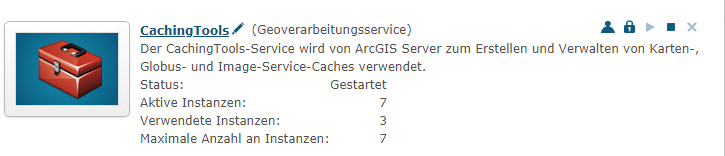

Despite the need to render like hell as not all tiles are created, the server manager shows that not all instances are "active" (screenshot from a test system with 8 instead of 22 cores):
Sometimes it peaks at 6 instances but mots of the times it is showing 3...
