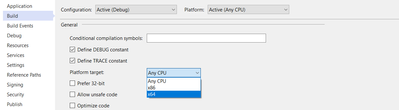

It's possible. Try building the project with either *64bit platform or AnyCPU with "Prefer 32-bit" unchecked.
Once the project is built properly, the code should be able to bind server license (Bind(ProductCode.Server)) and checkout server license (Initialize(esriLicenseProductCode.esriLicenseProductCodeArcServer)).

just to add a bit of context, the suggested code works in 64bit mode, and my test code that failed in 64bit mode was related to the "ComReleaser" in the "ESRI.ArcGIS.ADF.Connection.Local" assembly, that probably isn't working on 64 bit. removing this reference, the arcobjects code that "do the actual work" (besides checking the license) works as expected.
