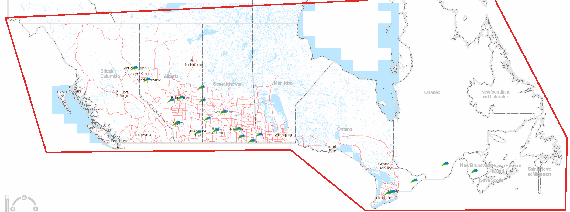

I'm having an issue with ArcGIS Server (10.3.1) where it wont cache the east side of Canada.
The map projection is ..
WGS_1984_Web_Mercator_Auxiliary_Sphere
WKID: 3857
The extent used is pretty much something like the red line. I've played around with a few variations (using province polygons, changing the projection) nothing seems to fix the problem.
Any ideas?

Conversely, you could create 3+ different areas of interest (three different polygons) as AOI inputs, and then run 3+ update cache jobs referencing those polygons. That way you can keep your vertices without generalization and (hopefully) complete the jobs. You could also use scale dependent rendering where at small scales you have generalized features, and at large scales you have more precision. You'd still likely need multiple cache jobs for large scales.
