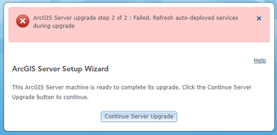

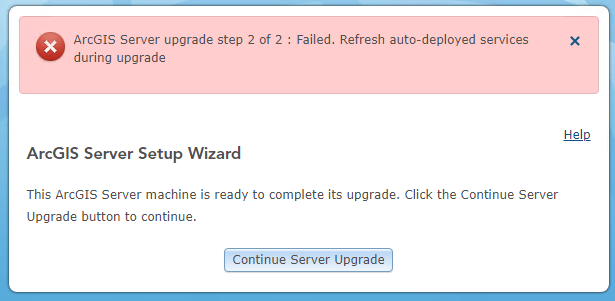

We are attempting to upgrade one of our Servers from 10.9 to 10.9.1, and are getting the error message below on post-install.  OS is Windows Server 2019.
Server was working just fine prior to update, the service account has permissions in all the necessary places.
Any ideas what to look at to fix this issue?
